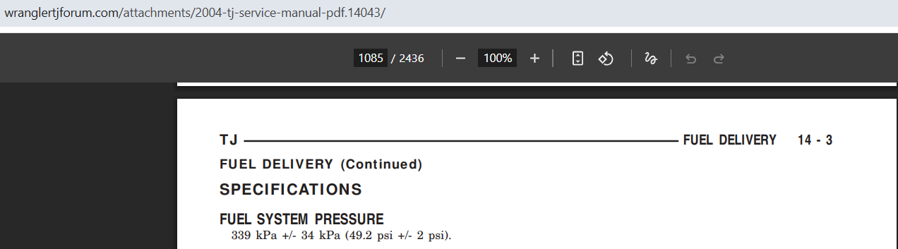

2. per the service manual, I think is says the 2004 is supposed to be Fuel specification is 400 KPa +/- 34 KPa (58 psi +/- 5 psi), but i thought is was lower than that in other threads i have seen.
I just want to know if this could be a potential issue, as dropping the tank is an ordeal.

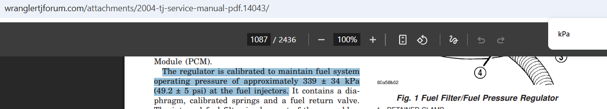

ok i did find this reading the Service Manual.
The regulator is calibrated to maintain fuel system operating pressure of approximately 339 ± 34 kPa (49.2 ± 5 psi) at the fuel injectors.
so maybe it is good?
