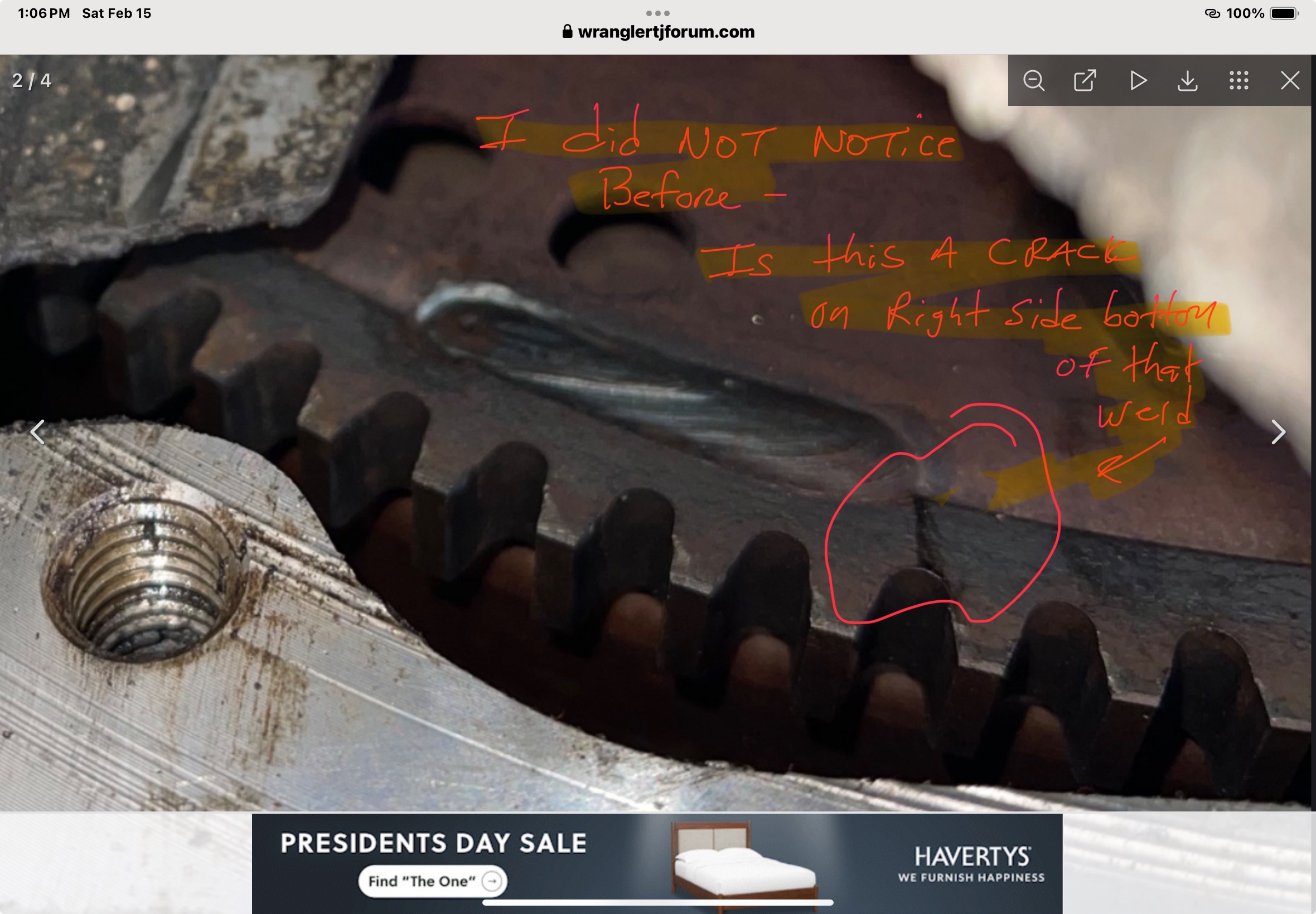

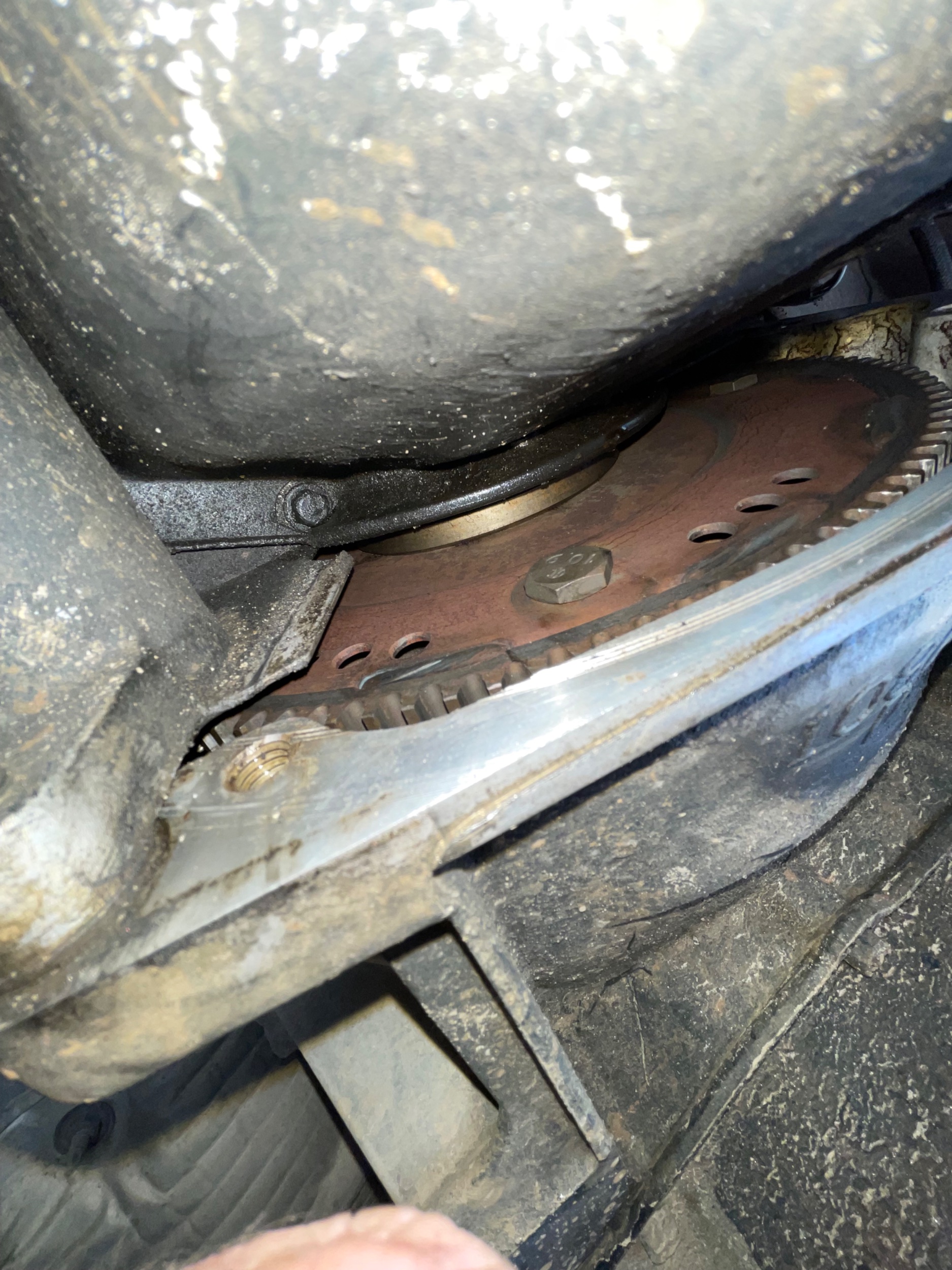

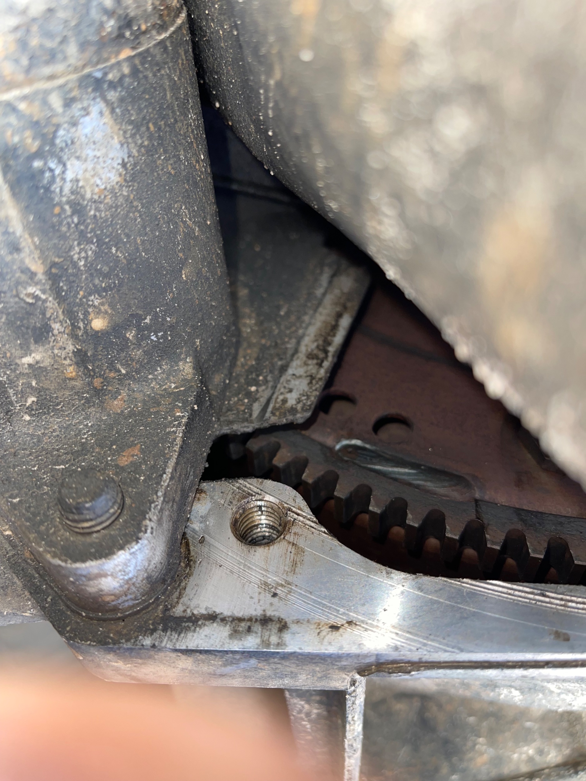

I know it was said on another thread but really check the flex plate
I did check the flex plate about a month ago ago…I didn’t see any cracks at all. I even started the engine with the inspection cover was off (have a video of that) and it was rotating true, no noises and no wobble at that time.
Maybe I need to check it again

I was looking at that photo agin closely …looks like either the ring gear was spliced together…I see a piece of metal..that’s 180°
Right above that tooth and an locking ledge above that…
You were correct! I don’t know how you figured that out but my master mechanic…check it out today..and said it was a “ Whipe” and wiped it off…he also check the other sections of the flex plate and it all looked good.
I am glad I was correct , that is much better for you ! Ive been around the block a time or two . Thanks for letting us know what was found !
