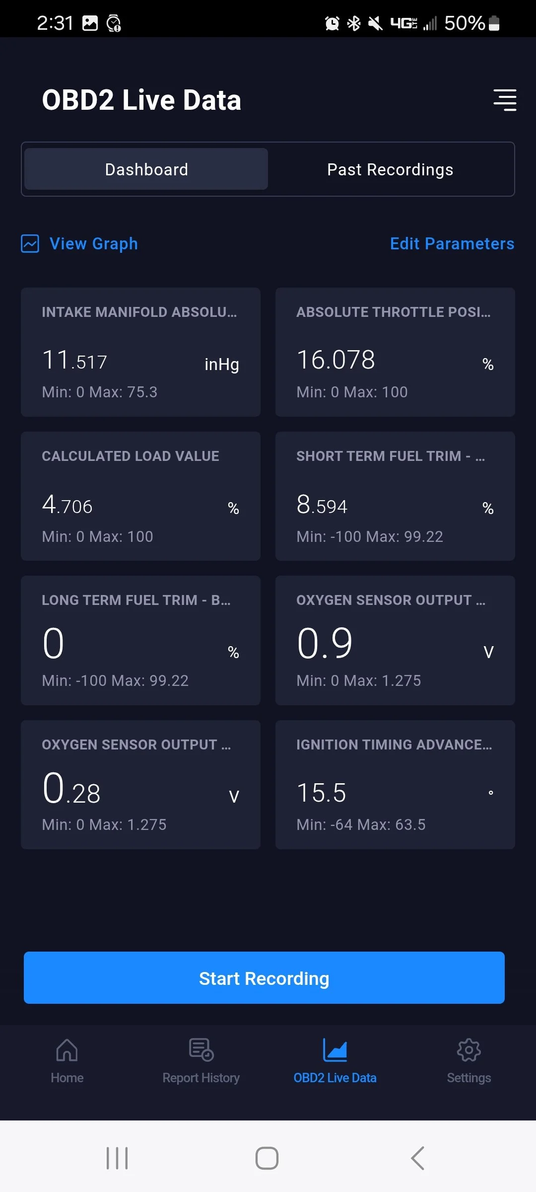

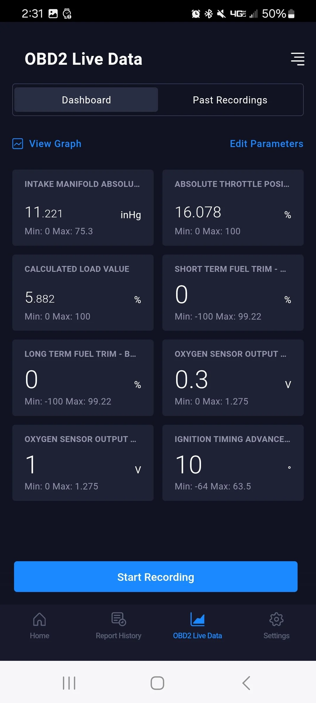

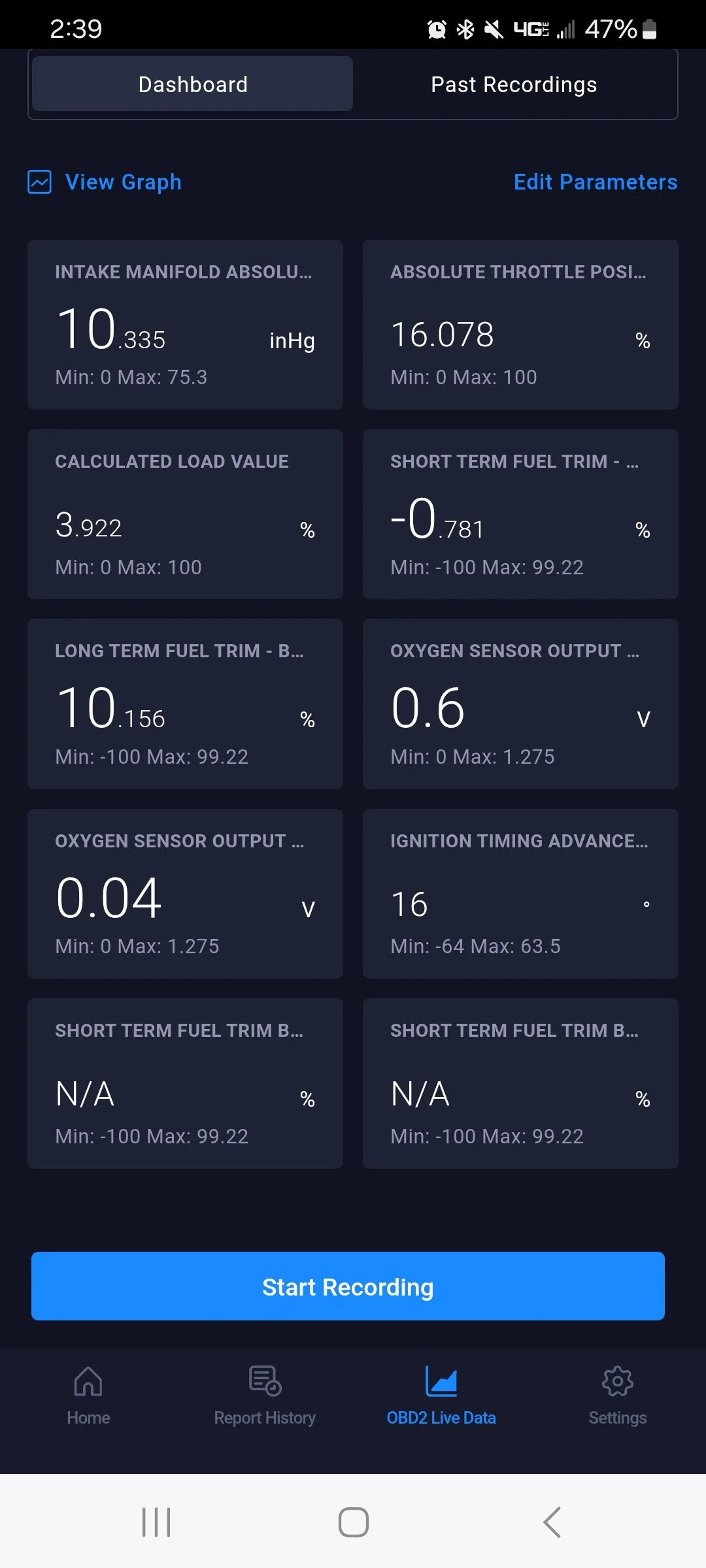

Try reading live ODB data and see where your fuel trims and O2 voltages are at. A $30 Bluetooth dongle and Torque Lite will do that.
Check and make sure your intake is tight. Clean your IAC. Check for vacuum leaks.
Might want to try running it without the downpipe (front) O2 to rule out a plugged CAT.

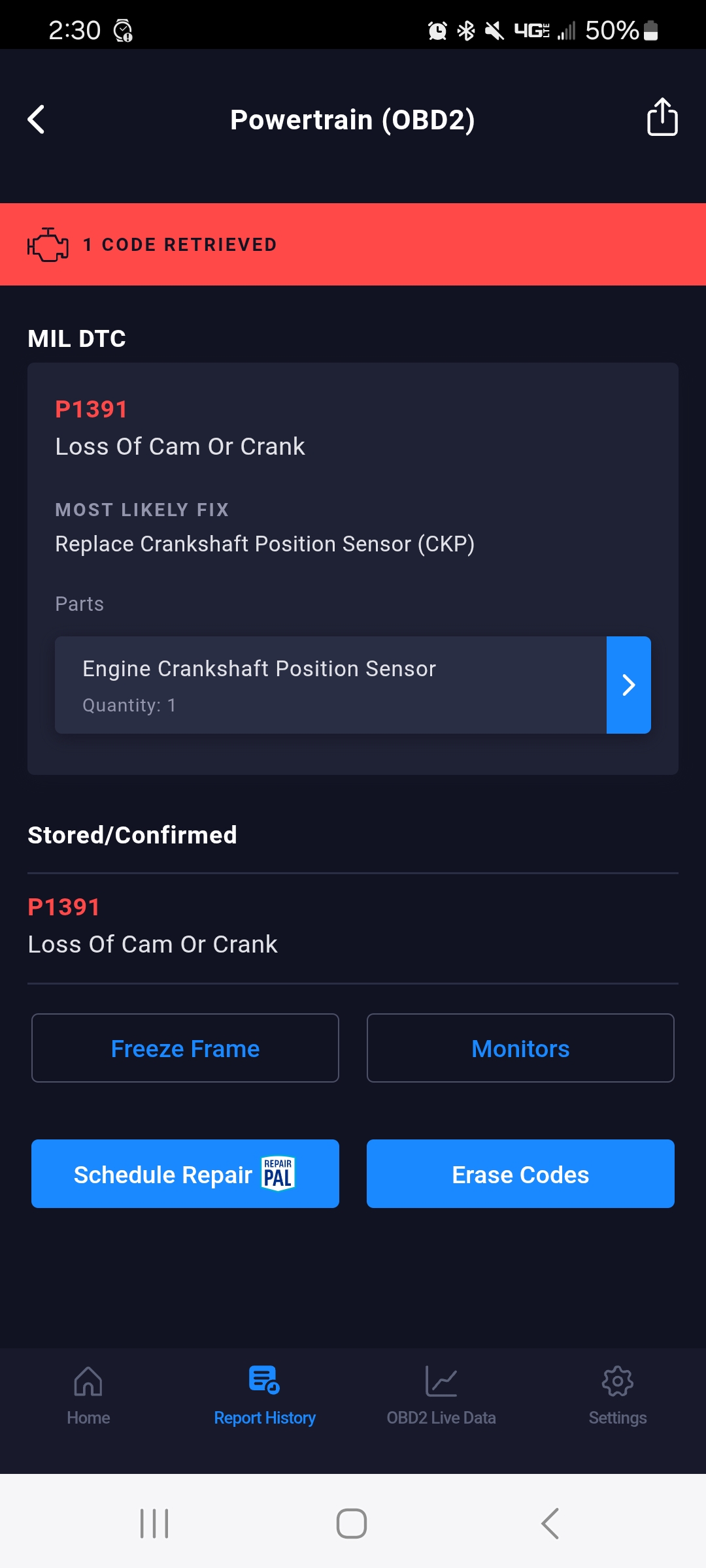

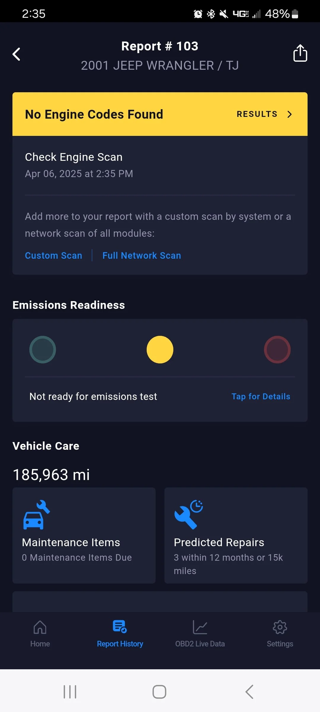

Now after running it at 2k rpm's for about 5 minutes it shows no errors and is idling fine. 🤔

What would you make of all of this? 😂
