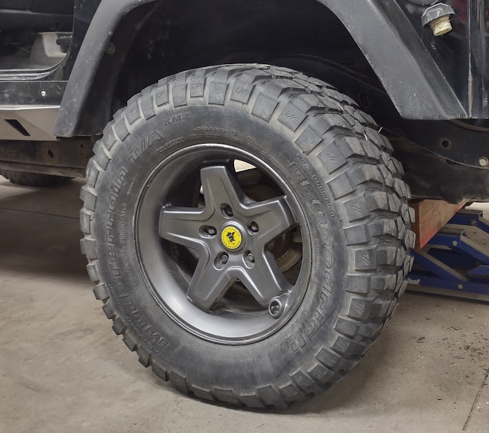

I don't have a ton of direct comparison experience. I did run a set of 35x12.5-15's for a short time. I didn't like them, at all. I could feel the extra sidewall squirming around in corners. The 35x12.5-17's I have now are way more better-er in almost every way vs those 15's in the picture.
I haven't run a flotation size 33...Only the 285/70R17's. I also haven't run narrow tires vs wide ones on the same vehicle. I do know I haven't been able to tell a difference between the narrower 285 metric vs the 12.5 flotation from a traction perspective. If anything, my BFGs in a 285/70R17 hooked better than my 35x12.5-17 General Grabbers. But that is all butt dyno...I really don't like my Generals. As soon as I have an opportunity, I'm going with a Baja Boss AT.

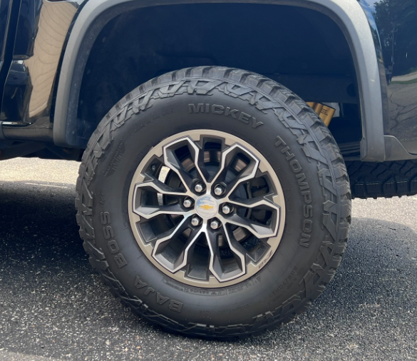

What tire is that? I thought about grey but i don't think it would fit my white/black jeep
Yikes,that is what i was afraid of. Are you fking with me on the rim and tire size? That looks aweful compared to mjonesjr's mammoths.

They are Mickey Thompson Baja Boss AT's. I love these tires; no noise and are wearing amazing.
