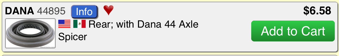

Can someone please direct me to the correct Spicer Pinion Seals for my '02 TJ X 4.0. I find 2 rear pinion seals that say both will fit my '02 front Dana 30 ...the Spicer 44895 AND Spicer 50660. (I think it takes the 44895). It says that the Spicer 43805 fits the rear Dana 35. Help please.
Thanks… weird that rock auto shows the 44895 as the Dana 44 rear then.

The parts manual is a bit confusing and doesn't really clear this up, but RockAuto lists 44895 for Dana 44 and Dana 30 front reverse rotation, which would be the high pinion Dana 30, which the TJ did not have. 50660 is what RockAuto shows for normal Dana 30 (low pinion), which is what the TJ came with.
So 50660 for stock, 44895 for high pinion axle swaps.
